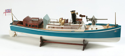

    The quickest picture to find is this one of Billing Boat's model of a steam picket boat from HMS Renown, c.1880; note the Maxim gun. Those used in WW1 would have been very similar and often still steam powered; they came in useful at Gallipoli (well not very useful actually, Majestic's picket got sunk even before Majestic herself), and also in the East African campaign.
  3. Adrian Roberts
    Correction, the gun on the model is not a Maxim, its a 3-pounder or possibly a 6-pounder Quick-Firing gun.
