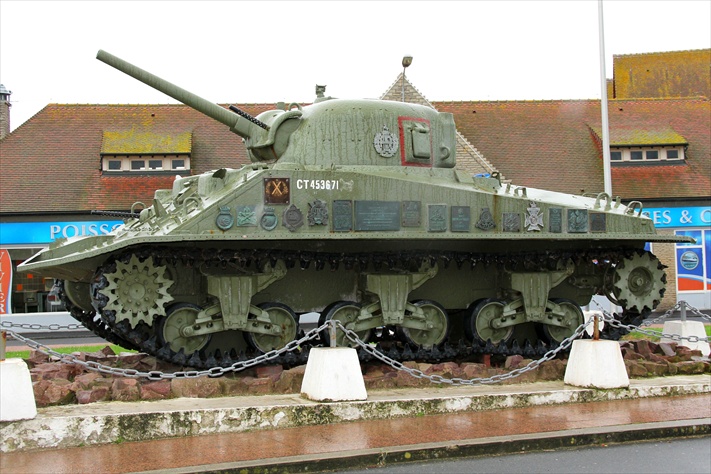

  12. aghart
    The armour on the DD tank is not modified or scaled down/removed in any way. Also that is not a regular M4 in the photo. It is an upgunned version, a US version of the British Firefly Sherman. take away the canvas screen on the DD tank and you have a standard M4.
    DD stands for Duplex Drive

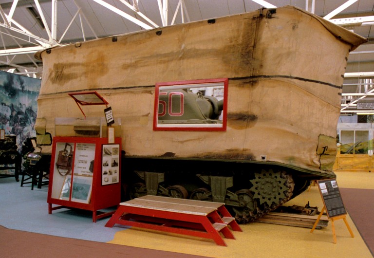

  13. aghart
    Picture shows the Sherman DD tank at the Tank Museum, Bovington, England
      103.9 KB
      1,054

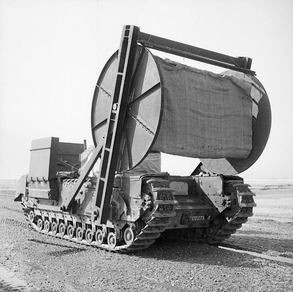

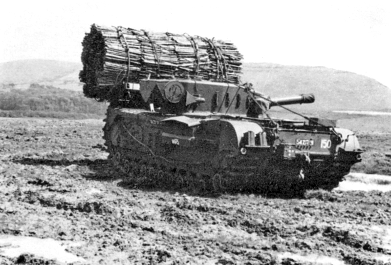

  14. aghart
    Photo's show the special tanks developed for the Normandy landings. The DD sherman is seen without it's "skirt" which shows that it is a fully armoured production tank.

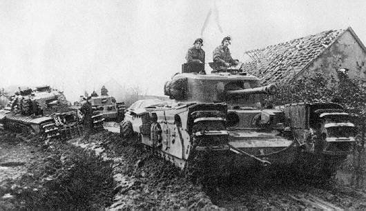

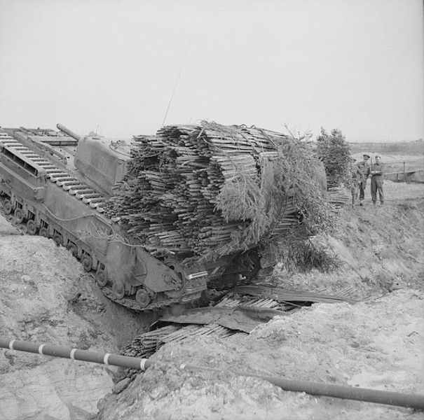

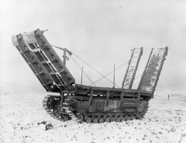

    The Churchill AVRE shows the Petard bunker busting mortar, it also carried a fascine which could be dropped into Anti tank ditches to allow armour to cross.
    The Bobbin rolled out a roadway to allow wheeled vehicles easy access off the beach. The ramp carrier was used a a bridge for armour,drive into the ditch/river , drop front and rear ramps and you have a bridge for the other armoured vehicles to use.

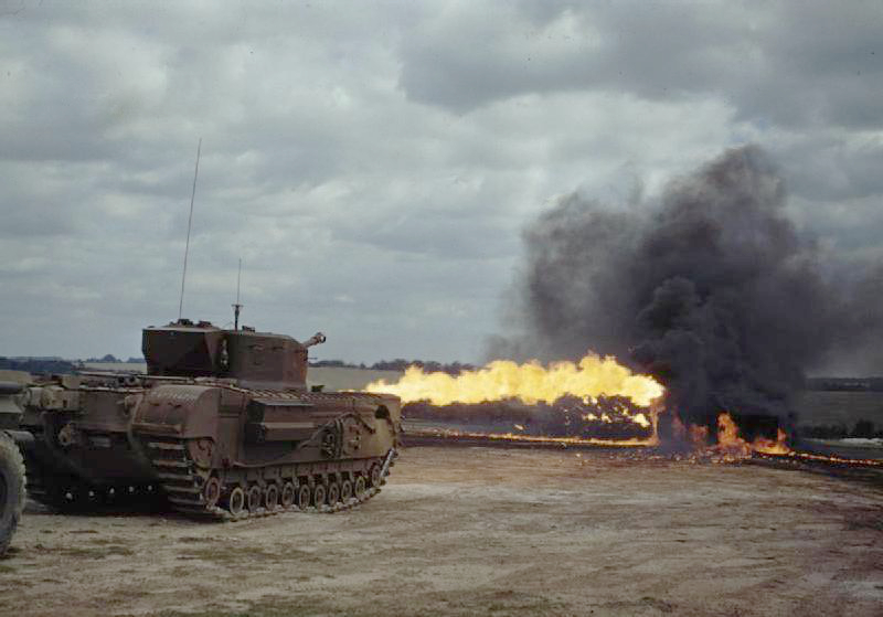

    The crocodile has a flame thrower in the front, fuel for the weapon is located in a towed container behind the vehicle.

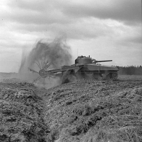

    The Sherman crab was used to explode mines creating safe routes through minefields.

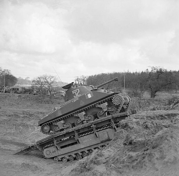

  15. aghart
    Churchill_Crocodile_01.jpg 607px-Armoured_Ramp_Carrier.jpg 605px-AVRE_01.jpg
    Photo's show a Sherman using a Churchill ramp, and a Churchill AVRE (Armoured Vehicle Royal Engineers) with a fascine crossing a ditch using a previously dumped facine. A colour photo of a crocodile flamethrower in action
