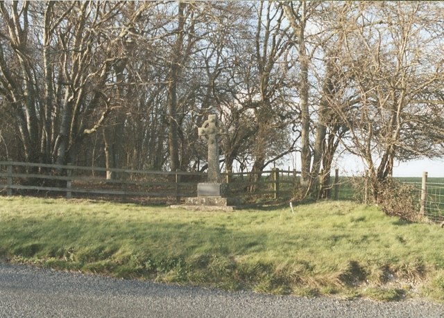

    At Winterbourne Stoke is a Celtic Cross erected to the memory of Major A. W. Hewetson, who was killed whilst flying on the 17th July 1913, when he crashed in a Bristol Prier-Dickson monoplane during the test for his aviator's certificate. The cross is surrounded by six wooden posts, railings and a gated entry.
